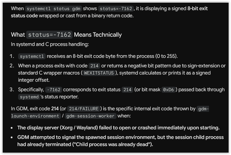

Comecei a fazer uma série de despistes recomendados pelo Gemini
rm -f /tmp/.X0-lock /tmp/.X11-unix/X0
# Check Xorg crash logs
cat ~/.local/share/xorg/Xorg.0.log | grep -E "\(EE\)"
# Check full GDM unit error log
journalctl -u gdm.service -b --no-pager -n 50
sudo systemctl restart gdm
# reinstalar o GDM
dnf reinstall gdm gnome-shell
# Check GNOME Shell crash logs
journalctl -b _COMM=gnome-shell -p err
# Clear out X authority and dconf lock files
rm -f ~/.Xauthority ~/.serverauth.*
sudo rm -rf /tmp/.X11-unix /tmp/.X*-lock /tmp/.ICE-unix
# Ensure /tmp has correct system permissions
sudo chmod 1777 /tmp

Print do gemini com a explicação
