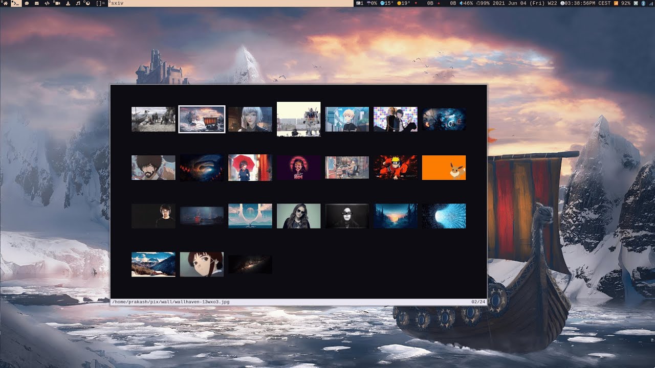

Fonte: GitHub - siduck/chadwm: Making dwm as beautiful as possible!
